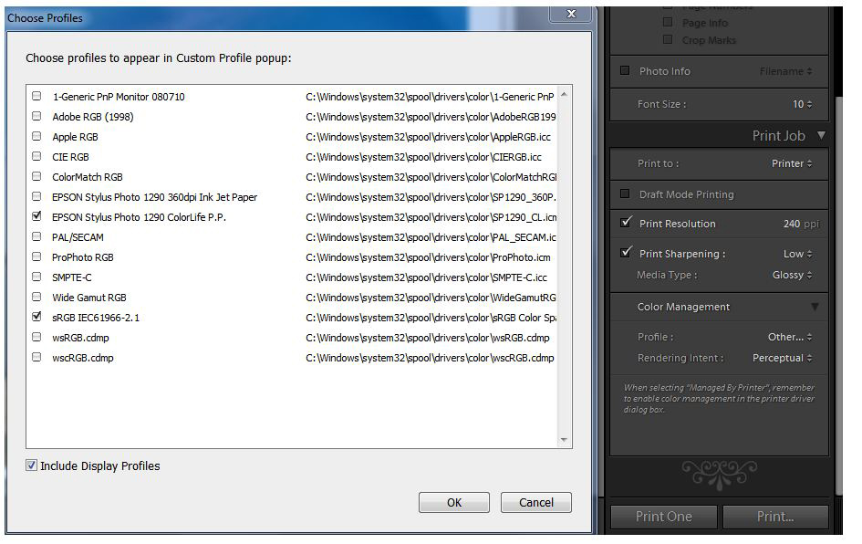

    Hi Audrey - switch to the Print module and scroll the right hand side all the way down and you will see Print Job and below that 'Color' Management. Your printer driver should have loaded a suitable profile for Epson Premium Glossy Photo paper. Epson does tend to use mnemonics for its papers and the usual mnemonic for Epson Premium Glossy Photo Paper is PGPP. So when you click on the currently selected profile, a box should pop up that offers one or two options, as well as the option of 'others' - if PGPP is not a default, click on 'others' to see a list of all available profiles and look for 'PGPP'.

      I had already done that. It used to work in LR2 or perhaps it was Vista. Anyway, as I now have Windows 7 and LR3, it doesn't work.
      It may be that there are no drivers for my old Epson Stylus Photo 1290 within Windows 7!

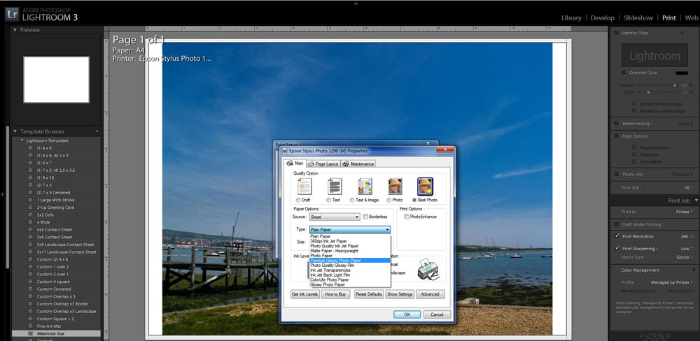

      Anyway, here is what I see.

                  Here is an update, Audrey - see if you see anything like these in the profile list:
                  • SP1290 RC - Premium Gloss Photo Paper
                  • SP1290 MP-H - Heavy Weight Matt
                  • SP1290 GF - Glossy Film
                  • SP1290 PP - Photo Paper
                  • SP1290 PQP - Photo Quality Paper
                  The mnemonic is different to the later printers for premium glossy photo paper (PGPP). You need to look for 'RC'.
                  If it's not there, you can download the profiles from the Epson UK website at:
                  http://www.epson.co.uk/Printers-and-...rivers-Support
                  ..look under ICC Profiles.

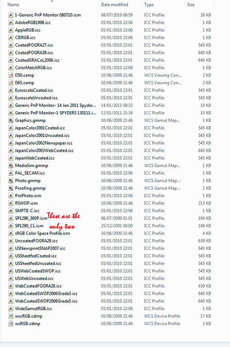

                    I may be wrong but it could be that the profiles require activation. If this is the case Audrey go to My Computer click your C: drive and follow this path Windows>system32>Spool>Drivers>Color here you will see a list of every profile on your machine. Find the Epson drivers you are missing and right click if I am correct about your problem you will get a list headed by install profile, click this and that should solve your problem.

                      Patrick see the attached thumbnail with my available profiles. There are only 2 and these are the two which appear in Lightroom.
                      Thanks to all of you for your interest.

                          This all started because I profiled my computer with the Club's Spyder3 last night and then did a print which did not match my screen.
                          Another profile later and 2 more prints of a colour chart that I downloaded, and still I was no nearer when printing through CS3 and letting PS manage colour.
                          I imported the chart into Lightroom and because I couldn't find the profile, I used the printer dialogue box where all the Epson papers are available. I used "Photo quality Glossy Film" (recommended by the people who profile monitors etc." and I checked "Managed by Printer" and "Enabled Colour Management in the Printer Driver Dialogue box."
