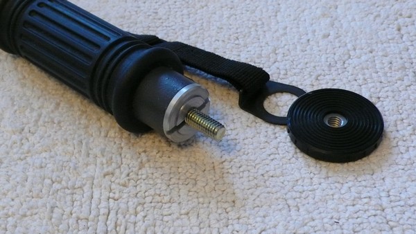

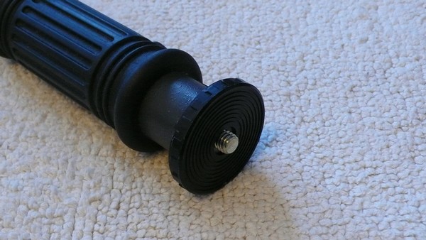

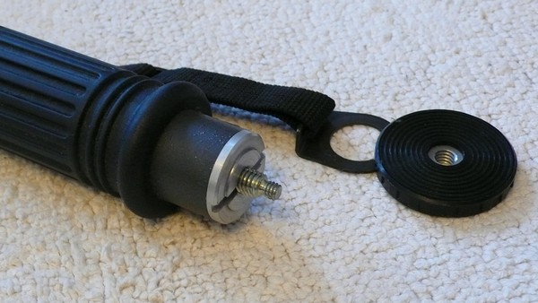

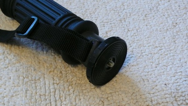

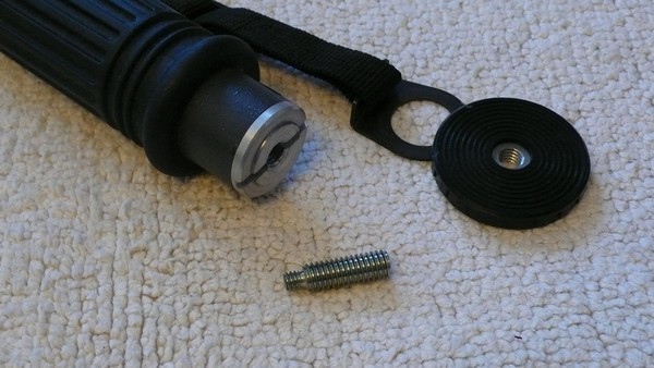

          If the problem you have is the size difference of the monopod thread, one way is, as you seemed to have already tried, to use a converter from 3/8 to 1/4". There seems to be one more way...Not sure if this applies to your particular monopod, though. ( I imagine most likely it does.)
          Well, I just wanted to say that a thread used on most monopods/tripods have two-way usage.
          The one I have at hand is not Manfrotto but the thread size can be changed easily like this. (I guess my Manfrotto tripod, not at hand now, has also the double sided thread, iirc.)
          To shorten verbal explanation, I attach some pics.
          pic #1: currently the 3/8" thead is shown here.
          pic#2: dismantle the plate
          pic#3: you will see the same thread has both 3/8" and 1/4" thread on each side.
          pic#4: So just use the other side of the thread
          pic#5: then finished.
          If this has nothing to do with your problem just ignore this, please.
